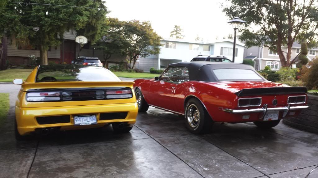

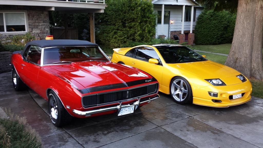

Different Car, same passion (Camaro is WAY cooler, not to mention more $$$)
